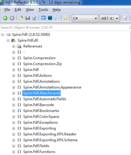

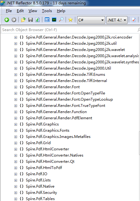

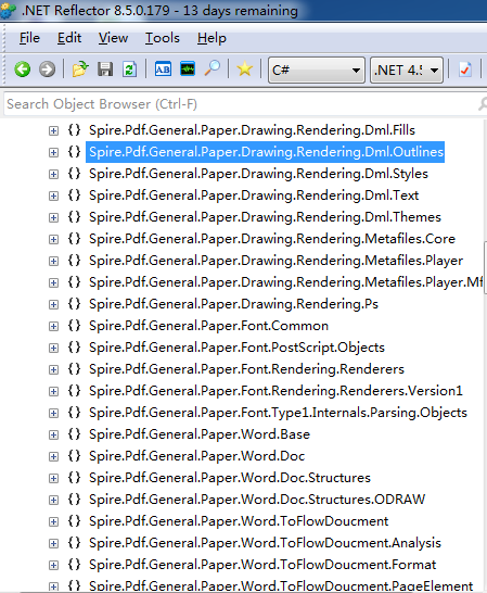

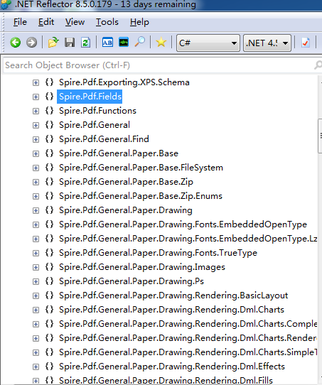

    [ToolboxItem(false)]    public class HtmlConverter : UserControl, sprᰐ, sprᶪ, sprṳ, sprẝ, sprẏ    public enum ImageType    public class PdfHtmlLayoutFormat
private Metafile ᜍ();    static HtmlConverter();    public HtmlConverter();    public int Authenticate(ref IntPtr phwnd, ref IntPtr pszUsername, ref IntPtr pszPassword);    public HtmlToPdfResult Convert(string url, ImageType type, int width, int height, AspectRatio aspectRatio);    public HtmlToPdfResult Convert(string html, string baseurl, ImageType type, int width, int height, AspectRatio aspectRatio);    public HtmlToPdfResult Convert(string url, ImageType type, int width, int height, AspectRatio aspectRatio, string username, string password);    public Image ConvertToImage(string url, ImageType type);    public Image ConvertToImage(Stream stream, Encoding encoding, ImageType type);    public Image ConvertToImage(string url, ImageType type, int width);    public Image ConvertToImage(Stream stream, Encoding encoding, ImageType type, int width);    public Image ConvertToImage(string url, ImageType type, int width, int height);    public Image ConvertToImage(string url, ImageType type, string username, string password);    public Image ConvertToImage(Stream stream, Encoding encoding, ImageType type, int width, int height);    public Image ConvertToImage(string url, ImageType type, int width, int height, AspectRatio aspectRatio);    public Image ConvertToImage(string url, ImageType type, int width, string username, string password);    public Image ConvertToImage(Stream stream, Encoding encoding, ImageType type, int width, int height, AspectRatio aspectRatio);    public Image ConvertToImage(string url, ImageType type, int width, int height, string username, string password);    public Image ConvertToImage(string url, ImageType type, int width, int height, AspectRatio aspectRatio, string username, string password);
    [DispId(-5512)]    public int CustomizeDownload();    protected override void Dispose(bool disposing);    public Image FromString(string html, ImageType type, int width);    public Image FromString(string html, string baseUrl, ImageType type);    public Image FromString(string html, ImageType type, int width, int height);    public Image FromString(string html, string baseUrl, ImageType type, int width);    public Image FromString(string html, ImageType type, int width, int height, AspectRatio aspectRatio);    public Image FromString(string html, string baseUrl, ImageType type, int width, int height);    public Image FromString(string html, string baseUrl, ImageType type, int width, int height, AspectRatio aspectRatio);    public Image FromString(string html, string baseUrl, ImageType type, int width, int height, AspectRatio aspectRatio, string username, string password);    public Image[] GetImagesFromString(string html, string baseUrl, ImageType type);    public int QueryService(ref Guid guidService, ref Guid riid, out IntPtr ppvObject);int sprẏ.GetSecurityId(string pwszUrl, IntPtr pbSecurityId, ref uint pcbSecurityId, ref uint dwReserved);    int sprẏ.GetSecuritySite(out IntPtr pSite);    int sprẏ.GetZoneMappings(uint dwZone, out IEnumString ppenumString, uint dwFlags);    int sprẏ.MapUrlToZone(string pwszUrl, out uint pdwZone, uint dwFlags);    int sprẏ.ProcessUrlAction(string pwszUrl, uint dwAction, IntPtr pPolicy, uint cbPolicy, IntPtr pContext, uint cbContext, uint dwFlags, uint dwReserved);    int sprẏ.QueryCustomPolicy(string pwszUrl, ref Guid guidKey, out IntPtr ppPolicy, out uint pcbPolicy, IntPtr pContext, uint cbContext, uint dwReserved);    int sprẏ.SetSecuritySite(IntPtr pSite);    int sprẏ.SetZoneMapping(uint dwZone, string lpszPattern, uint dwFlags);    int sprᶪ.GetContainer(object ppContainer);    int sprᶪ.GetMoniker(uint dwAssign, uint dwWhichMoniker, object ppmk);    int sprᶪ.OnShowWindow(bool fShow);    int sprᶪ.RequestNewObjectLayout();    int sprᶪ.SaveObject();    int sprᶪ.ShowObject();
   以上是对PDF操作的相关类和方法的查看,由于此软件为商业软件,只能查看部分对外公开的代码,但是从可以查看到的代码就可以看出其内部实现的复杂度。如果需要详细了解:http://www.e-iceblue.com/Introduce/free-pdf-component.html#.WEEFj_l962w。

    以上介绍了一款收费不开源的组件,没有更多的深入的去介绍,由于组件不开源,无法进行反编译,毕竟存在版权问题,如果需要使用到企业级的文档操作组件,并且公司不缺钱的话,可以使用一下此组件,组件的底层方法封装度较高,所以在使用的时候,开发者所需要考虑的是如何去使用组件完成功能。
