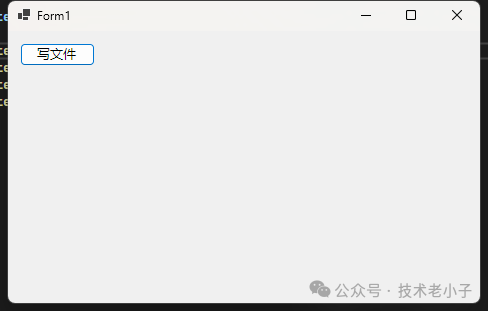

写文件
using (var stream = File.Open("d:\\a.dat", FileMode.Create))
    using (var writer = new BinaryWriter(stream, Encoding.UTF8, false))
        writer.Write(1.37F);
        writer.Write("博格巴何时能复出?答案还是个问号。");
        writer.Write(10);
        writer.Write(true);
