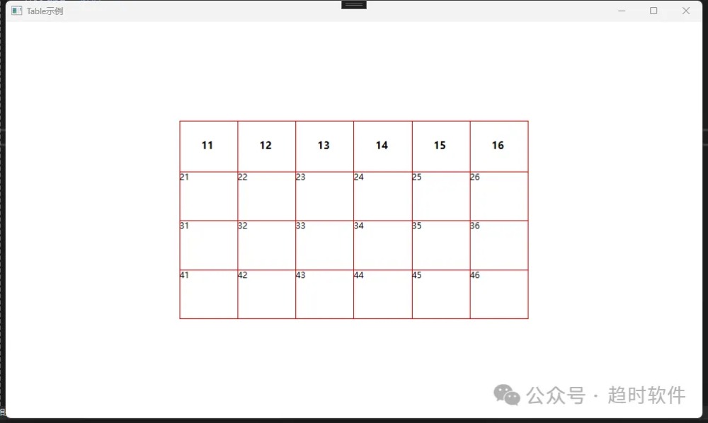

四、行效果
4.1 默认效果
<qs:Table
    Width="50%"
    Height="50%"
    Align="Center"
    Border="1 solid red"
    Valign="Middle">
    <qs:Tr>
        <qs:Th>11</qs:Th>
        <qs:Th>12</qs:Th>
        <qs:Th>13</qs:Th>
        <qs:Th>14</qs:Th>
        <qs:Th>15</qs:Th>
        <qs:Th>16</qs:Th>
    </qs:Tr>
    <qs:Tr>
        <qs:Td>21</qs:Td>
        <qs:Td>22</qs:Td>
        <qs:Td>23</qs:Td>
        <qs:Td>24</qs:Td>
        <qs:Td>25</qs:Td>
        <qs:Td>26</qs:Td>
    </qs:Tr>
    <qs:Tr>
        <qs:Td>31</qs:Td>
        <qs:Td>32</qs:Td>
        <qs:Td>33</qs:Td>
        <qs:Td>34</qs:Td>
        <qs:Td>35</qs:Td>
        <qs:Td>36</qs:Td>
    </qs:Tr>
    <qs:Tr>
        <qs:Td>41</qs:Td>
        <qs:Td>42</qs:Td>
        <qs:Td>43</qs:Td>
        <qs:Td>44</qs:Td>
        <qs:Td>45</qs:Td>
        <qs:Td>46</qs:Td>
    </qs:Tr>
</qs:Table>

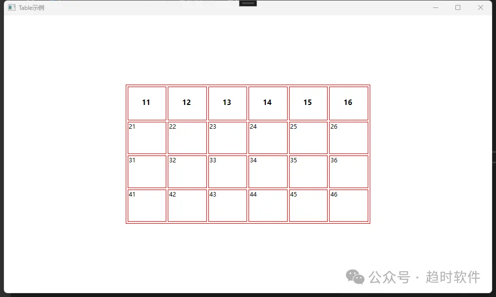

4.2 合并相邻的线
<qs:Table
    Width="50%"
    Height="50%"
    Align="Center"
    Border="1 solid red collapse"
    Valign="Middle">
    <qs:Tr>
        <qs:Th>11</qs:Th>
        <qs:Th>12</qs:Th>
        <qs:Th>13</qs:Th>
        <qs:Th>14</qs:Th>
        <qs:Th>15</qs:Th>
        <qs:Th>16</qs:Th>
    </qs:Tr>
    <qs:Tr>
        <qs:Td>21</qs:Td>
        <qs:Td>22</qs:Td>
        <qs:Td>23</qs:Td>
        <qs:Td>24</qs:Td>
        <qs:Td>25</qs:Td>
        <qs:Td>26</qs:Td>
    </qs:Tr>
    <qs:Tr>
        <qs:Td>31</qs:Td>
        <qs:Td>32</qs:Td>
        <qs:Td>33</qs:Td>
        <qs:Td>34</qs:Td>
        <qs:Td>35</qs:Td>
        <qs:Td>36</qs:Td>
    </qs:Tr>
    <qs:Tr>
        <qs:Td>41</qs:Td>
        <qs:Td>42</qs:Td>
        <qs:Td>43</qs:Td>
        <qs:Td>44</qs:Td>
        <qs:Td>45</qs:Td>
        <qs:Td>46</qs:Td>
    </qs:Tr>
</qs:Table>

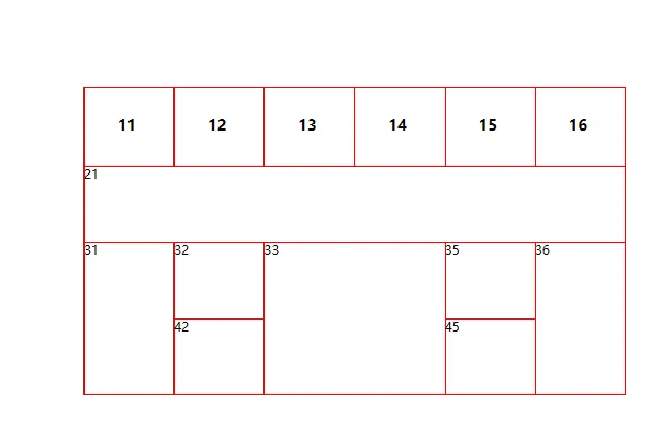

4.3 合并单元格
<qs:Table
    Width="50%"
    Height="50%"
    Align="Center"
    Valign="Middle">
    <qs:Tr>
        <qs:Th>11</qs:Th>
        <qs:Th>12</qs:Th>
        <qs:Th>13</qs:Th>
        <qs:Th>14</qs:Th>
        <qs:Th>15</qs:Th>
        <qs:Th>16</qs:Th>
    </qs:Tr>
    <qs:Tr>
        <qs:Td ColSpan="6">21</qs:Td>
    </qs:Tr>
    <qs:Tr>
        <qs:Td RowSpan="2">31</qs:Td>
        <qs:Td>32</qs:Td>
        <qs:Td ColSpan="2" RowSpan="2">33</qs:Td>
        <qs:Td>35</qs:Td>
        <qs:Td RowSpan="2">36</qs:Td>
    </qs:Tr>
    <qs:Tr>
        <qs:Td>42</qs:Td>
        <qs:Td>45</qs:Td>
    </qs:Tr>
</qs:Table>
